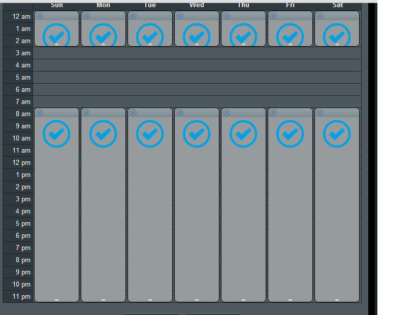

I never used Parental Control myself (was actually the first time I ever went to that page), but in theory you should be able to configure something looking like this:
What I did was to select 12am-2am, then 8am-end_of_the_day. I repeated it for every day. This should work in theory, otherwise it means something is buggy in Asus's Parental control.
Are you able to recreate this layout?

First, is the router set to the correct time zone? It automatically defaults to GMT, IIRC.
Second, is the router getting the correct time from the NTP server you are using? If not then set it to a nearby NTP server (I do and it works fine).
Third, If you start at 8AM of any day you should be able to drag the allowed access time zone through to the end of that day, go laterally into the next day and then set it to stop allowing access at 2AM. If that proves to be problematic then using the method Merlin described may be easier (set two allowed periods per day 12AM-2AM & 8AM-midnight).
That was the ticket. Time was set wrong. I had the wrong time zone and daylight savings wrong. All is good. Every thing is working.
