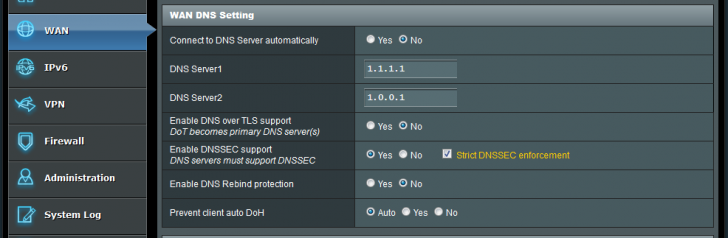

I was able to get everything working by adding it into the WAN DNS Setting section of the router and while this appears to work (I'm seeing blocked traffic in the Pi-Hole dashboard) all of the traffic appears to be coming from one device (my router). Here's what that config looks like on my router...

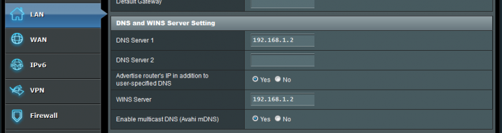

From what I'm reading on various forums, there's another (supposedly better) way to set this up in the LAN section (instead of the WAN section)... DNS and WINS Server Setting. Here's what mine currently looks like (not set up for Pi-Hole)...

The wan DNS settings should be resolvers outside of your LAN. I used Quad9. The LAN DNS and WINS server, DNS Server should be 192.168.1.2.

This doesn't appear to work. Tailing the pi-hole log doesn't show any activity. Here's my settings for WAN and LAN respectively...

On the LAN page, turn off the Advertise router’s IP... option and force devices to renew their DHCP leases. You should start to see some activity.
THANK YOU! That was the problem. It works perfectly now.

But looking at your WAN DNS screenshot, I think you might want to disable DNSSEC if you continue to use the pihole IP for the router WAN DNS. You do not have DNSSEC enabled on the pihole, based on your other screenshot. What DNS servers does the pihole use?
I've got the Pi-Hole set to use Cloudflare DNS (1.1.1.1 and 1.0.0.1)
I've gone in and checked "Use DNSSEC" on the Pi-Hole and restarted everything.
