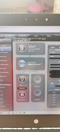

I have followed steps from 0 setting up using my IP providers password and PPPOE.
The router days its connected but I can't access the internet.

Just went through the first stage (for the root node) but with the same result.
Router says it's connected yet I can't ping any sites.

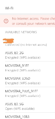

Thanks so far for all the advice, I'm back to square one with a router that I can't get to connect to the web.
I would be willing to pay someone who could fix this for me with a linkup via team viewer or similar.

With the ASUS few I cant get it to connect to the net at all, with merlin it can connect via ethernet but WiFi had no connectivity.
I'm sorry if I'm asking stupid questions, but I really have no idea what I'm doing, any thoughts on what should be happening?
