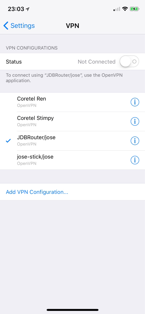

On the VPN point, given OpenVPN app integrates with the native iOS VPN settings directly it’s a non issue to me...
