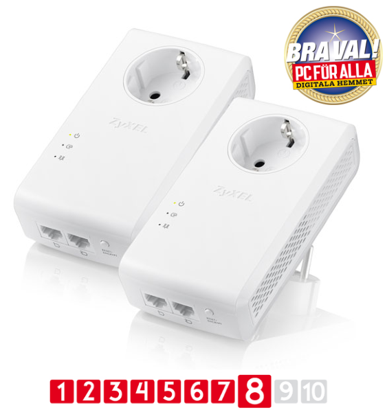

You only need a ASUS RT-AC68U as AP NO need for the Netgear EX7000 right now to see if it works for you.
If your wife dont like cables you can use Homeplugs/Powerplugs

if you still find issues with coverage you can do as pege63 suggested and look at power line adapters to help you place the router in a better location

I think the homeplugs/powerplugs do not work for me. I live in a 4 storey house and each floor has its own breaker. I read that in this case powerplugs do not work properly, am I right?

Powerplugs will not work, right?
