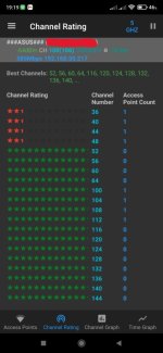

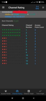

As always, thanks very much Colin for your help. Okay, so here's the thing....I'm not sure which one is the issue. My suspicious is that it's the 2.4GHz one that's the problem. So here is what I've done:
  • I've adjusted the antennas a little - no difference
  • I've downloader 'Wifi Analyser' app on my android phone and it seems that: channels 1,2,3 of 2.4Ghz wifi are rated poor, but all 5ghz channels are rated good.
Please kindly have a look at the screenshots I've attached which show the above and let me know your thoughts.

That's some rather strange results from the WiFi app. I've never found the apps to be particularly accurate but I've never seen it show all channels (apart from 1-3) being "good". Do you live a long way away from your neighbours?
How close to the router were you when you did the test?
I would change the 2.4 GHz channel to 11 and see what the app thinks of that.
I suggest you change the 5 GHz bandwidth to 80 MHz and the channel to 100. Does the signal strength increase?

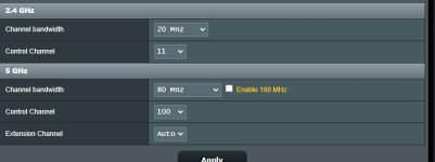

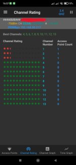

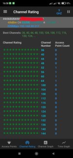

I followed what you said and changed 2.4ghz to ch11 and 5ghz to 80mhz/ch100. The 5ghz shows good strength on app for all channels, but now the ch4 to 11 on 2.4ghz show poor strength. This is getting weirder or the app is crap.

Yeah, I don't think I trust those results. Try a different app.
It's also possible that the phone you're using cannot report the information properly. You might need to run the app on a different phone to get sensible results.
EDIT: Bear in mind that the "Channel Rating" is not a measure of signal strength. It's mostly just trying to determine if there are nearby routers operating on the same channel. To see the signal strength look at the "Access Points" screen, where it says dBm.
To be honest, this is the only open-source app that I know that is supposed to give good results, unless you know of any other app?

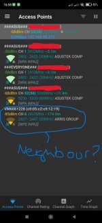

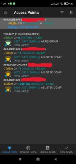

I stood approx. 10 metres away (Router is upstairs and I'm downstairs) and retried the Access Points Screen. The results are attached and your right, they don't make much sense. For example it shows that the ASUS SSID is 30.6m away, but at the end it shows the same SSID being 54.6m away.
I have the same app and another one on my phone. I stood in a similar location to you and got consistent dBm figures with both apps.
Ignore the "distance" number. That just seems to be a guess based on the signal strength.
So, I got -66 dBm on 5GHz and -69 dBm on 2.4 GHz. So my 5 GHz signal was the stronger of the two. I was getting about 250 Mbps throughput on 5 GHz.
Try comparing the 5 GHz signal strength on channels 48, 52 and 149. It's important to try and be standing in exactly the same position and orientation each time you do the test.
The reason for testing those bands is because the router's legally allowed output power varies for different channel groups. The allowed output power also varies by country. I'm in the UK, what country are you located in?
