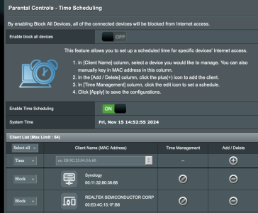

BUG in firmware 37031. If i am enable time scheduling to block some devices, for some reason, router block every connection from all devices, even if "enable block all devices" turned off
