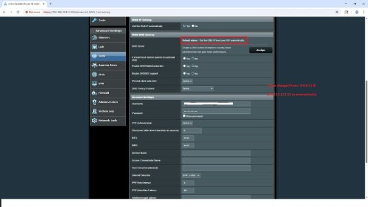

What do you have configured for the WAN DNS Setting?
9.9.9.11
149.112.112.11
Please see attached photo

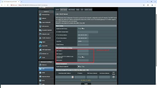

What do you have configured for the LAN > DHCP Server > DNS and WINS Server Setting?
Nothing please see attached photo

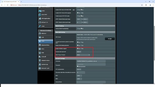

Depending where you are located Quad9 can have occasional issues especially if DoT and or DNSSEC are enabled.
I am in New Zealand and none of them are enabled please see attached photo
