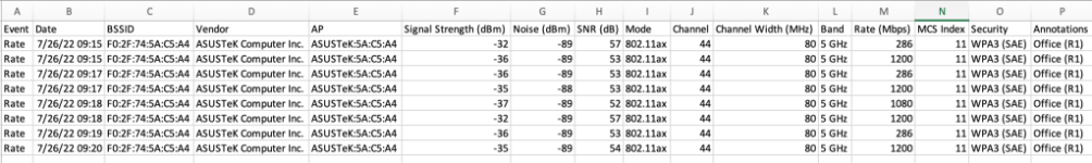

Unfortunately, that doesn't seem to have done it. I turned off Roaming Assistant per the article but I'm still seeing the issue. I've attached an example of what I'm seeing.
