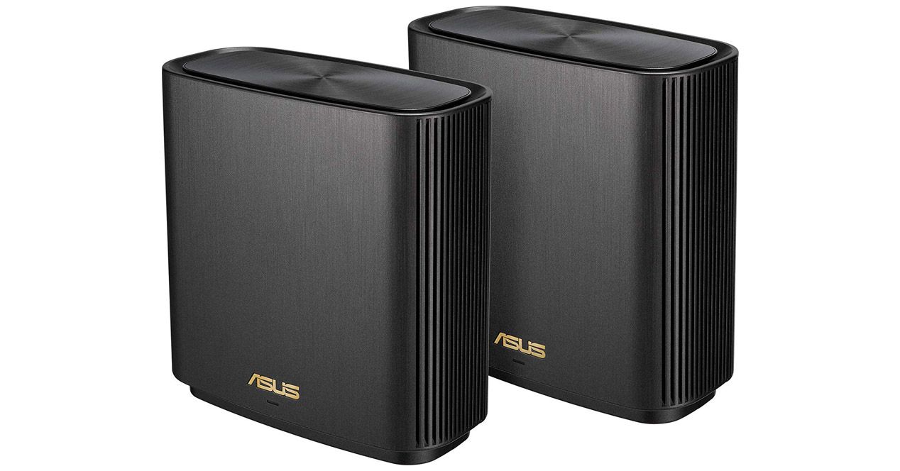

Asus ZenWifi AX XT8 - A two week technical review (And that 160mhz issue)
JagoUK
First the TL;DR
  • 160mhz backhaul not possible in areas of UK due to weather radar on 5.625ghz.
Channel 124 is 5.620ghz *See map below*​
This removes one of the BIG features of this product.​
I think it could be fixed, but will it?​
  • Fronthaul 5G-1 limited to channels 36-64
Backhaul 5G-2 limited to channels 100-140​
I think this is a software limitation and would be great if it is fixed to allow all channels.​
  • A lot of apps show 160mhz as only 80mhz.
  • Amazon Firesticks don't work on all 5ghz channels. If your 2.4ghz & 5ghz SSID's are the same you could be forced onto 2.4ghz causing stuttering during playback of Blu-ray rips.
  • LG TV's struggling with streaming 4k 60fps UHD rips. (100mb LAN only, 866.7mb AC Wi-Fi. Tested 4k 60fps UHD rip peaked at 110mbps)
  • 2.5gb WAN on router cannot be set to 2.5gb LAN to node, or at least not in mesh mode.

Purchased plugged in, lets get setup.
Being a previous user of Asus I was familiar with the setup but chose to try the easy setup via the app.
I went through all the steps in the app and even chose against my normal scepticism to allow remote access for monitoring. (Previously I used OpenVPN server on the BT home hub 5 and intend to set this up at a later date)
I got the units both talking to each other and noticed the the node had a white light but the main router still had a blue flashing light.
I note another user has had this issue. Not sure what caused it but after a factory reset, setting up via web interface and not picking remote access both units setup fine.
Time to test the setup to see if it is delivering the panacea of wireless connectivity in my house.
And then the trouble begins….
Where’s my 160mhz (4804mbps) backhaul?
I found the option to enable 160mhz, and even though it accepted the settings the app I was using (WifiAnalyzer for Android on S10+) kept reporting 80mhz.
