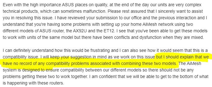

I've contacted Asus support and was not impressed, their solution was RMA which I don't believe...

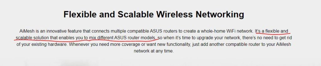

Well, the way Asus advertises it per Asus website: "AiMesh is an innovative new router feature that connects multiple ASUS routers to create a whole-home WiFi network. It’s a powerful and flexible way to solve your WiFi problems that also makes the most of your existing hardware: you can mix different ASUS router models, so when you upgrade there’s no need to throw away your old router" that's kind of one of the main selling points as a customer in my opinion.

Anyway, I assumed it had something to do with it (mixing) but Asus support claims they should still work together... I gave up regardless and will just use the ET12 as my main and repurpose the AX92U's.
I say the statement from support is BS...

I figured something along those lines but expected "Asus AiMesh" to sort that all out and deal with it as that's how they market it... AiMesh is supposed to work with AiMesh per Asus, I didn't come across any caveats regarding this specific router (ET12) and other non 6E AiMesh routers.
