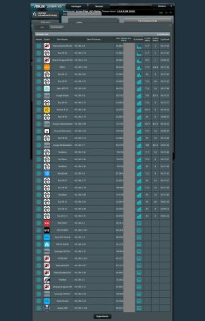

This firmware version runs very well and stable for me, but the fact that the client list no longer updates after a few minutes is of course a no-go and really annoys me. :( Especially if you - like me in the last few days - have integrated several new WLAN devices and then cannot tell/see how good or bad the WLAN connection is with the XT8 Mesh.
I can only hope that Asus fixes this very quickly, otherwise I would probably downgrade the firmware. The only question then is which old firmware version should I downgrade to? No idea. :)

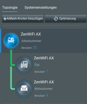

I also have around 30 WLAN clients here and I find that this firmware version works very well for me. My house has around 140 square meters of living space. There is one XT8 in the kitchen (ground floor), one in the hallway (ground floor) and one on the first floor in the study. The XT8 in the hallway is connected to the XT8 in the study via LAN cable.
All devices - including my three Nest Hubs - have very good Wi-Fi reception and permanently. There are no Wi-Fi interruptions and the IoT devices don't cause any problems either. I have now also activated Wifi 6 mode on all WLAN bands
I have now also activated the Wifi 6 mode on all WLAN bands and there are no problems with it - e.g. with any IoT devices. Things were different with older firmware versions and there were problems when Wifi 6 was activated.
The worst WiFi connection is to a Tasmota socket (TAS-SD_06) in my garden shed that has a water pump connected to it. The WiFi to two of my Dahua outdoor cameras isn't that good either, but they are connected via PoE anyway and the WiFi is just a backup.
Apart from the bug with the client list, I am very satisfied with the firmware (so far).

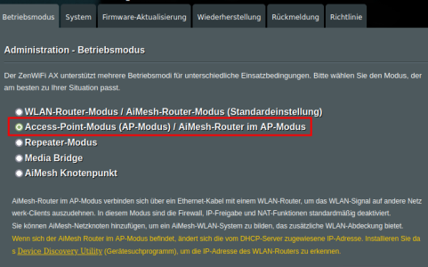

Yes, you are right, I use AP mode. It works very well for me here.
I would rather be able to determine the WLAN connection myself than leave it to some “automatic system". I noticed that the automatic optimization that you can run either for the entire mesh system or just for individual clients doesn't really work. For example, clients in the living room are connected to the XT8 in the hallway, even though there is also an XT8 in the living room. That's why I don't really trust this automatic system. 😆

BTW: Very strange. After a restart yesterday, the Client list is now continuously updated and works again for about 20 hours now. I had restarted several times in the last few days and the display of the client list kept stopping after a few hours.

In my mesh, I have the main router and three additional nodes. One of these nodes uses wired backhaul, while the other two rely on wireless connections.
While running version 386, the wireless backhaul on 5GHz for both nodes was extremely reliable (not a single fallback to 2.4GHz, ever). However, since I switched to this new firmware, one of the nodes consistently switches to 2.4GHz after a few hours of operation. The only solution to revert to 5GHz is by rebooting the problematic node.
Before considering downgrading back to version 386, is there any specific action I should take?
hi..i have a mesh network. The main router has updated itself to this version even i have disabled "auto updates" (only security ones are allowed).... When my node doesnt complete this update, it get pushed off the mesh network. Node was kicked out and impossible to re-pair.....even trying to delete my node on my main router was tricky....Reset by wps method, pinhole pushed..i tried everything...even "rescue mode" was unsuccessful, no node was detected....i was starting to think it was bricked during update. After multiple tries....i was able to update node to same version, then added to my mesh network again.
This update seems to work well but after hours of nightmare messing with reboots and setting up all again
