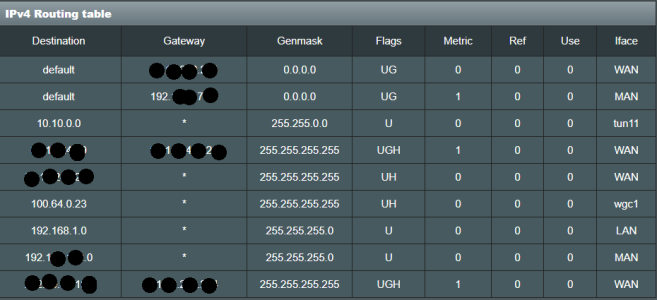

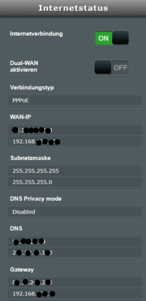

Hello, I have found a small problem with Asuswrt-Merlin 3004.388.8_2. When switching from ‘automatic IP’ to ‘PPPoE’, I have duplicate entries in ‘System log - routing table’ as well as in ‘Internet status’. I have already tried a factory reset and reinstallation. Always the same.
Is there a solution?

No. Once the IP from the provider and then the IP from the upstream FRITZ!Box I would like to use PPPoE and my provider supports it. But when I specify PPPoE during installation, the same result is obtained. Everything has already been done and it worked with the previous versions.
____
EDIT: Ashes on my head. Problem already solved. Under ‘WAN - Internet connection - Special requirement of the Internet provider’ -> ‘Activate VPN and DHCP connection’ Deactivated & it runs again as usual.

That setting - where can I learn more about it? somehow it's auto activated by the setup wizard...
AFAIK, it was used by very few providers. I believe Russia's Beeline used it back in the day - DHCP would provide you with an IP within their own network, and then you would establish an L2TP tunnel using that IP to gain actual Internet access. Hence the "VPN over DHCP`.
