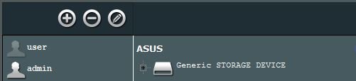

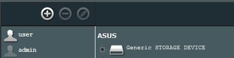

Sean Nelson
I have two issues with this update (was from 384.xx) --
[1] I have set up two profiles/accounts for SMB, one named "admin" that has full access to everything, and one named "user" that has more restricted access. I set up access for clients (phones etc.) with the "user" profile and it had worked well for years. After the update I could no longer access SMB with the "user" credential, but could still use "admin" to access. I opened the config page on the router, and found that for "user" the options of removal and edit (the minus and pen icons) has been greyed out, i.e. I could not remove or edit that profile; those are still available for "admin", and if I create another profile, it could be edited/removed, and I could access SMB with it even though it has the same restrictions as the "user" profile.
[2] I got warning that NVRAM is full after update. I don't really have fancy stuff so could not find ways to reduce much, except for the empty variables ("name="), so I cleaned them and reduced NVRAM use by 20%. Problem is that all these empty variables would come back (and NVRAM near full) after a reboot, unless I had the cleaning command run after each reboot. [this may not be new to this update, but I never got NVRAM warning before so did not pay attention.]
Sean Nelson
I've attached screenshots. when "admin" was selected, all 3 buttons (add, remove, edit) are available. When "user" as selected, only "add" is available.

dave14305
Part of the Furniture
This can likely happen when the accounts get "out-of-sequence" in nvram. If you look at the underlying nvram variable over ssh login:
nvram get acc_list
You will probably find that user and its password is listed before admin and its password. You probably also have errors applying any settings on the Administration / System page.
If you understand the "<" and ">" delimited field in the nvram output, you could reorder them correctly:
nvram set acc_list="admin>theencryptedpassword<user>theencrypteduserpassword"
nvram commit
service reboot
The last reboot command can be done when convenient. Otherwise just refresh the samba page and see if it works properly.
