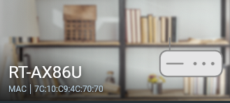

I have just updated my two RT-AX86U and RT-AX58U with no problem.
Only icon on aimesh nod is still missing, wrong path.
GEThttps://nw-dlcdnet.asus.com/plugin/productIcons/RT-AX86U-2.png
[HTTP/2 404 Not Found 179ms]
Should be:
Screenshot 2022-02-12 at 19-50-22 ASUS Wireless Router RT-AX86U - AiMesh.png
Screenshot 2022-02-21 at 16-34-22 ASUS Wireless Router RT-AX86U - Network Map.png
