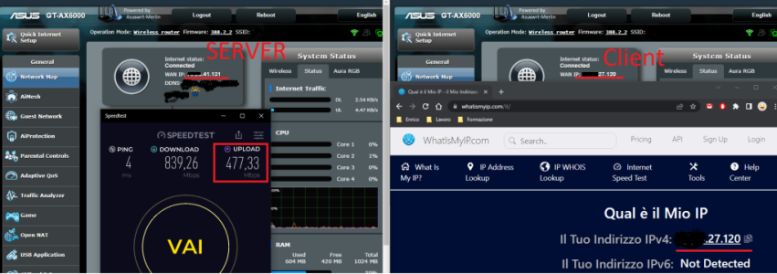

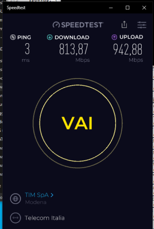

I have another question about the upload speed
this is my config: the router as server and the router as client WireGuard.
All the clients behind the client router go out with the asus router client ip (in this case X.X.27.120)
so the routing seems good but the upload speed is limited as if the web traffic goes through the vpn (about 500 mbit/s)
without vpn I have full bandwidth (about 950 mbit/s)
thanks
Same answer. :)
I understand the performance issue, but the routing should work fine.
with openvpn I didn't have this problem
Its not a routing issue there is no way you are having data going through different interfaces for different direction.
But Im curious as well, try to perform the test from a wired lan client instead. Testing on the router could give to low result if router processor cant keep up.
my config is:
GT-AX6000 as Router WireGuard with local ip 192.168.0.1
GT-AX6000 as Client WireGuard with local ip 192.168.2.1
all the clients behind the 192.168.0.1 came out to the web with the correct gateway public ip address X.X.41.131
all the clients behind the 192.168.2.1 came out to the web with the correct gateway public ip address X.X.27.120
only the traffic from 192.168.0.1 to 192.168.2.1 and from 192.168.2.1 to 192.168.0.1 go through to the vpn
so the speedtest should have the max speed (about 950 mbit/s)
in my case the client 192.168.2.122 (i7 16 GB RAM) wired conncted gets about 900/500 with the Wireguard Asus router client and about 900/900 with the WireGuard software client on win 10.
so the cpu is not the problem because on download I can get the max speed, the problem is only the upload test that I think is going out through the vpn instead of the gateway 192.168.2.1

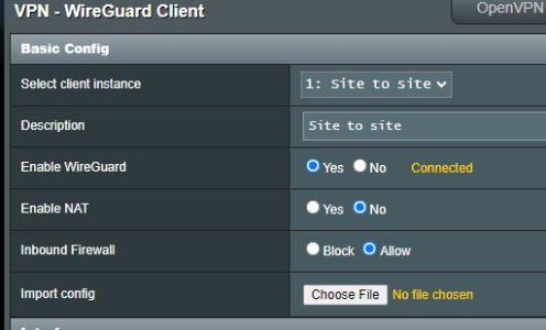

Did you turn off nat on your wg client?
Even if so I wonder if this is a side-effect of the implemented fc bypass. So you get nat hw accelleration in one direction but not the other. But its just a guess.
yes the NAT is off, see attachment.
the upload speed is the same of the vpn tunnel speed, so it's a very strange effect
