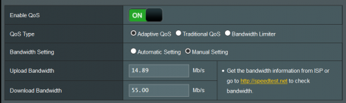

I've just reinstalled spdMerlin and I see that there are a lot of new features. One question I have is, if I want to try the new feature to automatically adjust the QoS settings, does that work with the standard Adaptive QoS or do I need to install one of the QoS enhancements from the amtm menu? In either case, how should the QoS settings be configured? I'm uploading a couple of images showing how the QoS settings are currently configured.

What router? What firmware?
If you have the 386.1_0 codebase or later, I don't think BW (auto) is working well right now (unless you're on the dev branches for all the scripts that need to interact to pull this feat off).

My router is an RT-AX88U and the firmware is 386.1_0

Needs Adaptive QoS enabled, FlexQoS isn't required but highly recommended
