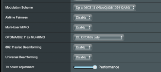

So I have around 320 Mbps download now. I'm going through control channels, but here's my settings (attached).

Measure the speeds with wired clients only. We don't know what are your wireless clients capable of. Test with all TrendMicro components disabled first. Enable them one at a time and re-test to see what the effect is. If you get lost in too many changed settings, reset the router to factory default and try again. Read what different settings do, Google is your friend.
Your latest wireless speeds don't seem to be that bad. That much difference between download and upload seems odd. Your best way to test wireless is from local sources in your LAN or as recommended in a previous post you can use your wired client WAN up/down speed tests as a reference point. Always remember that wireless performance is based as much on the performance capability of your clients as it is the wireless router. Of course wireless performance can also be effected by other conflicting wireless signals that are broadcasting in your area.
If you did finally decide to return the AX86S for the AX86U at least you know you shouldn't be getting a worse performing piece of hardware. The problem is that if your settings were the problem with the AX86S then any performance issues could still be there with the AX86U unless you correct them. If you do exchange for the AX86U post in the forum again and at least the other users here know what kind of performance you can expect from that router.
There has been some really good settings advice posted here to keep in mind. I always recommend going with upgrading the stock firmware and going default router settings first except turn off the dual band Smart Connect and use separate SSID names for 2.4Ghz and 5Ghz. I also recommend using WPA2 encryption for wireless instead of WPA2/3. You can always try enabling Smart Connect later but for some people trying to optimize wireless settings it can make it more confusing when doing testing and making settings changes for your clients at longer ranges. Whatever you decide to do let us know how it works out for you.
