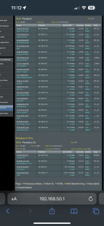

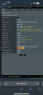

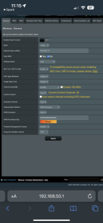

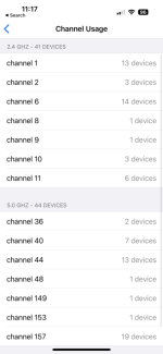

I have attached the log, wireless settings, and the channel analysis via airport utility.

Your screenshots are barely readable. I can't see your link speeds with 3 pixel high font, sorry. Don't use Wi-Fi analyzer type apps to determine the best channel. They only show you how many APs are using the channel, but not the available bandwidth per channel. You don't know how many are active. This is a common mistake. Better test the channels and see what works best for you. Use fixed non-DFS channels for better Wi-Fi stability.

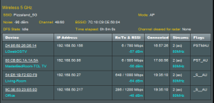

Got it! Nope I am in the USA. Please let me know if these are better for you!

Looks good to me. I would lock the channels instead of Auto to prevent disconnections on channel change. Devices with link speeds showing 6/780 are in power save mode. When testing Wi-Fi from mobile devices you may get lower numbers because power conservation is more important than maximum speed. Some mobile devices have aggressive power saving. Not sure why you prefer 2.4GHz band. AC/AX works well on lower signal levels. See example below. Have you made any changes to Professional settings page?
