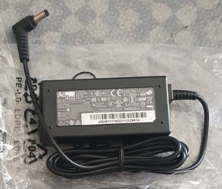

The other is a power brick type, rated at 19.5v, 2.31A, 45W max output, brand "AcBel". It has separate leads for UK and EU. Right angled adapter barrel type.
I have attached some images of both types of plug to demonstrate.

Use the one that came with the router you plan to keep. Power brick as you call it.
I would keep this one:
It's easier to plug the cable in any power outlet and hide the actual PS somewhere underneath. This is what I have with my AX86U unit.
The 45W power adaptor is the one I would use/keep.

Pick whichever works better for your positioning of the router. if the 90 angle works better then use that one. Brick might dissipate heat better than the wart and last longer. For all we know it just needs the 19V to power on and only .5A to run. If that's the case you could do a PD setup like my gateway using a trigger cable - https://www.amazon.com/gp/product/B08FRC39F4/?tag=snbforums-20 Of course you need to match the power requirements for such implementation and the pin size which should be displayed on the brick / wart. Looks a bit bigger than the 5.5 I'm using and might be a 7.4 plug on the end there.
I think I prefer the right angled connector.
I would prefer the straight connector, but the 45W PS is the better one in terms of convenience and max power. Why the straight connector? Because as you noted the LAN cables are straight anyway and the power switch is very close to the power connector. Angled connector makes the access to it more difficult in the most common use position. Most people would prefer the power cable hidden behind the router, not sticking out.
