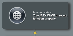

Then last night, I rebooted the router from web interface. When it starts back up, the symptoms are the same as Monday, except the same steps don't fix it. When diagnosing again, while watching the web interface and plugging in the ethernet to WAN, a message on the main page would say "Internet status: Your ISP's DHCP does not function properly." This led to an internet search which resulted in some suggestions of changing the WAN DHCP mode from aggressive to normal and cloning MAC (because when connecting WAN ethernet to computer, it worked fine). But that didn't work. I tried the 2.5G port as WAN and had same issue. I tried setting up an android phone as WAN source via USB to have SOME internet, but I'm not sure I set it up right.
