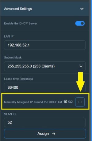

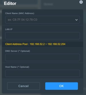

No issues using YazDHCP ("develop" version - v1.0.7) to import main LAN client DHCP server manual IP address assignments previously saved from Asus-Merlin 3004.388.x firmware into Asus-Merlin 3006.102.x firmware. Only manual assignments I had to do manually were the Guest Network Pro clients on their respective Profiles, under Advanced Settings -> Manually Assign IP around the DHCP list, because I had the Guest Network Pro Profile setup option Use same subnet as main network set to disable.
