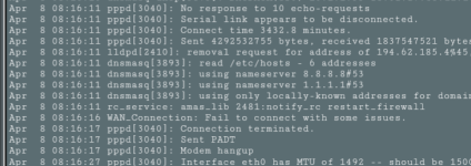

I am running 386.5_2 on my RT-AX88U with Dual WAN and once or twice a week I had noticed that it had failed over from my FTTP connection to my 4G.
I thought this may have been due to Dual WAN not working correctly so I have disabled Dual WAN and all seemed well for a few days but then this morning it disconnected again and the only thing that fixed it was a reboot of the AX88U.
When I checked the log it has an entry "Failed to connect with some issues" which is not the most helpful of messages.
Has anyone else experienced this and have you managed to fix it?
Thanks,
James
