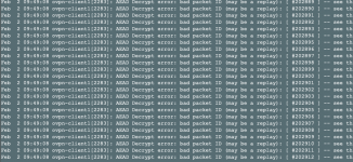

Problem 2: Regardless of which VPN provider I use and only with OpenVPN, I always get “AEAD Decrypt error: bad packet ID” displayed in the system log when I download downloads, and that a lot.

The VPN issue you state hasn't been repeated here that I can remember.
Does it cause actual problems or is it just you not understanding the logs?

How do I reset the router, I know everything and I also understand the protocol. The topic has already been discussed here a few times when I look in the search function. I just can't really find a solution.
No matter which firmware is used or which Asus router comes this error, at least I noticed that with me.
I'll attach the current syslog to this message.

Hello, please don't get it wrong, but it's not about USB I have a problem with the VPN as the SYSlog shows. I need help on how to get rid of the "Ahead Decrypt error" problem.
Or do I understand something wrong?
