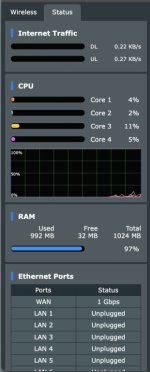

Need some help understanding why htop and the router's panel seem to be telling a different story. I have ample swap with amtm and entware running (1 active package –– conmon)
The problem goes away temporarily upon restart but resurfaces after a while.

This is not a problem. They are both showing the same thing. The GUI is saying that 97% of RAM has been allocated for use (including cache). htop shows the same information - the bar goes all the way to the right. Part of htop bar is in a different colour - this is the amount of used memory excluding cache and is the number shown to the right.

So I take it this amount is reserved? I was just intrigued since I had never seen the router report anything over 70% for me, thought it might've been an issue with the new firmware.
There is no "reserved" memory. The colours on the bar represent:
  • Green: Used memory
  • Blue: Buffers
  • Orange: Cache
Every time your router reads or writes something to the USB drive it will cache that data in unused memory, until ~97% of memory is allocated. This is why "free" memory will decrease over time as more and more disk blocks are cached. The appropriate amount of cache memory will be instantly freed up should another process require more memory.
