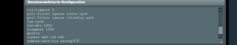

when i add an Ovpn config it says i have to shorten the text. i use 570 letters instead of 510 allowed. how can i get around this?
It destroys the entire config.

Sometimes certain directives in the config file aren't truly necessary. They may either be superflous, irrelevant, represent default values, something the server side will set for itself, etc. But without seeing *all* the directives, it's hard to say which are the best candidates for exclusion.
For example, tls-timoeut defaults to '2' when not specified, so it's not *vital* to have it specified just to change it to '5'. Or remote-crt-tls; it's *nice* to verify the remote cert, but it's not as if you *have* to, esp. if it forces you to exceed the maximum size of the openvpn config file.
ok strange. its the direct .ovpn file for asus merlin routers from perfect privacy. curious it doesnt work out of the box.
Biggest problem is, if you are not fully aware of what you need and which lines are optional its very hard to get it running.
You can't always be sure that someone hasn't configured a change to the config file and necessarily tested it to make sure the client still works, esp. third parties. Sometimes ppl just add stuff w/o such consideration (unforunately).
And yes, we're always at a disadvantage when we don't fully understand the technology we're using. In this case, I make it a habit to know more about what the VPN is actually doing w/ all these various directives by reading the documentation from time to time.
