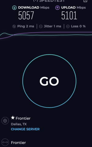

I have 5gbps FIOS. Previously, I had used AXE16000 as main router and was able get 5gbps up/down using the 10gb port as wan without any issues.
