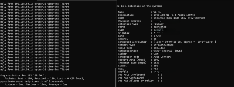

Soo I decided to run pings directly to the router while on 5ghz wifi (ax201 client)
Average ~2ms max 10ms after 100 pings.

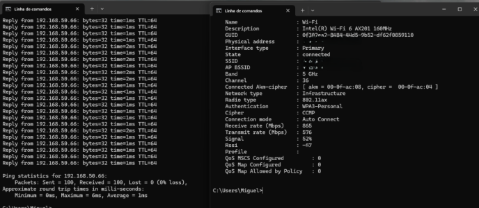

I then forced the client to the node (ax86s 192.168.50.66) and did the same test
Average 1ms, max 6ms.
