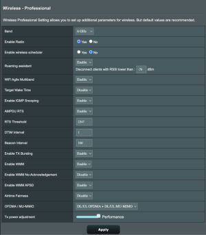

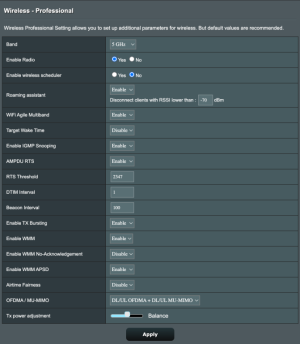

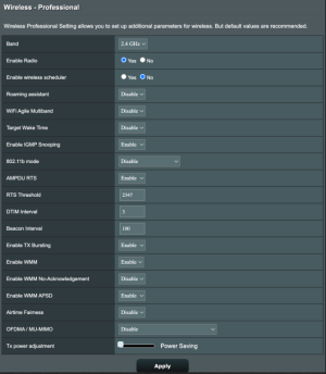

I've only adjusted power on the main router. I haven't touched the nodes.
I'm surprised by 2.4 Tx being on Power Saving and not Balanced for the IoT devices.
If I leave the router at anything higher, all my IoT devices connect to it for some reason, even though a mesh node is close to it. It was a solution for my particular network. I have 120+ devices, and this configuration helps share out the devices to the ET12 nodes.
Have you played with Beacon Interval for any power saving benefits?
I have tinkered with DTIM and beacon intervals, with minimal results, so I settled with the solution I did because it seemed to solve my issues.
I use DTIM of 3 and Beacon Interval of 200 for my iPhone and iPad. I don't have any issues with these setting using a ROKU. Desktop is wired and others are WiFi and not affected.
I'm in a smaller environment than both of you.
Edit: RSSI -65.
