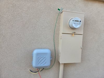

Out of curiosity, I went out and looked at the main breaker coming into the house, as well as the coax feed for internet (X-Finity). Looking at the XFinity feed, it doesn't seem like they grounded it right, as the grounding cable from the Coax box doesn't seem to making metal contact.
But if this was the issue, I feel like the modem would have gotten fried? Could a lack of coax grounding cause an issue to the Ethernet output of the modem to my fried router and further downstream?

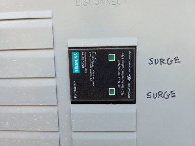

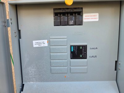

Here's some pics of the main breaker box - I assume the green boxes in the surge portion means they are still good?

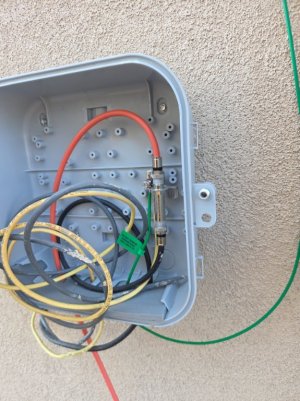

Also, just realized that the exterior Coax box has two un-terminated ethernet runs in them, that lead back to my interior networking box. On the interior, they are not connected to anything either, just sitting in the networking box. Could this have had a role?
Yellow and grey wires are the ethernet runs going back to the interior network box.

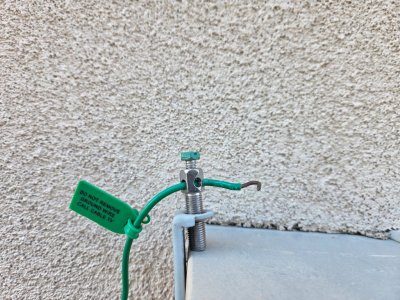

Being in the UK I'm not familiar with how you do things. But is this green wire electrically connected to this bolt? It looks like it might only be held in place by the insulation. Perhaps the internal part that screws down on the cable has a IDC that pierces the insulation that can't bee seen from this picture.
I'm assuming that the bottom of the bolt is making good electrical contact with the bare metal of this box thing (which in turn is grounded).
Your main disconnect box has built in whole house surge arrest. That will help with any power line spikes. They should be across each phase (L) to neutral (N), and across phase (L) to earth (G), and across neutral (N) to earth (G) , although the latter may be equivalent since the two buss bars inside the breaker panel (presumably inside somewhere) are tied together. Depends on what the local code requires and the authority having jurisdiction (local inspector) requires. You won't be able to see all those connections, but can look up the install sheet based on the model number. Siemens generally makes good equipment. Those can handle up to 22 k Amps before they use up the MOVs.
Is the electrical distribution in the neighborhood underground or on poles ?
Green is good on the two Siemens arrestors . Red means they are completely used up. The previous strike probably used up some of the MOV life.
The coax bonding is likely ok if allowed by local electrical code. Personally, i would not do it that way as there may not be bare metal contact under the meter box cover by that grounding clip. The grounding tap used is a vampire type that pierces the insulation to make the connection. It should be fine. It's really up to what the local authority allows the cable co to do.
Those unterminated ethernet ? CAT ? cables are just antennas. Plastic boxes would not shield from EMI if the strike was close enough. What are they connected to inside ? If they were connected to the router or a switch, yes , that could be part of the reason you had damage especially if they were all directly connected to the same switch or router lan ports.
And the yellow and gray cables are not coax ?
Yeah, it's legit. Vampire type tap. Would also be concerned about corrosion building up in the female threads connecting the bolt to the clip. Usually , stainless steel is not painted though.
Some jurisdictions allow this sort of bonding approach. You have to watch out for gaps opening up in the conduit coming up to the service disconnect box unless it is directly connected with an earthing wire to the earthing point/grid. Somewhere else there is an earthing mesh or set of rods that all of this ties to. Should be outside of the building structure, but i don't know what the local authority having jurisdiction allows. Usually, they follow the NEC explicitly, but they have room for local "adjustments". This is an area with highly variable moisture levels in the soil and lots of rock/gravels.
Yellow and grey cables are not coax, they are ethernet. On the inside at the networking box, they are terminated but connected to nothing. They sit alongside the other coax and ethernet runs that lead to 4 different areas in the house. Only coax hookup is the incoming connection for internet.

If they are not connected on either end, then any buildup would have to arc over which is not very likely. i would still suspect an elevated ground potential, reverse current flow, issue unless the surge protection circuits do not cover L-N, L-G, N-G.
i would not be surprised if you had additional device failures over the next few months from this hit.
