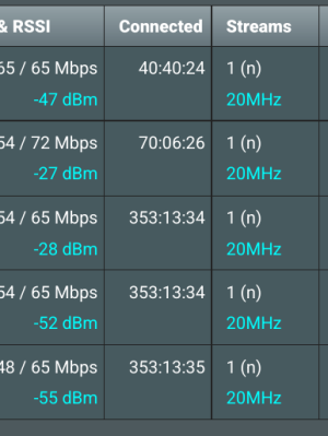

View attachment 67992View attachment 67993

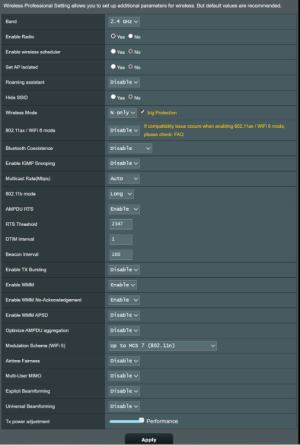

There are significant setting differences between my GT-AX6000 running on 3006.102.5 and those on your RT-BE88U ... however there is a bunch of settings that we both have - but are set differently in mine.
I have a rock stable router with zero dropped connections and plenty of disabled settings that you have enabled. For e.g. I have seen it recommended many times that Airtime Fairness be disabled ... etc.
see screen grab
May be worth trying some of them before you throw in the towel.

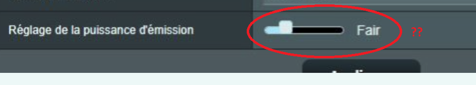

Also puzzled why you have the signal strength dialed back so much - mine is on full power.
