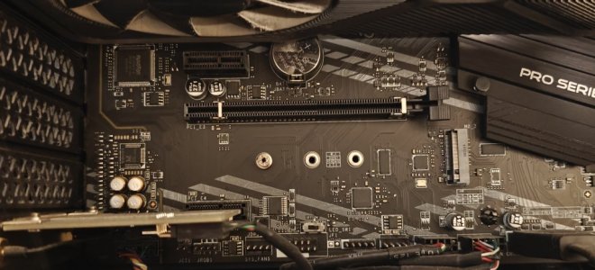

If only you had written me earlier,
I already got this https://www.amazon.com/dp/B08D71PVXG?tag=snbforums-20,
I was going to return it cause my motherboard doesn't have exact PCI slot for it I learned that PCI cards are universal
No idea what motherboard you have, but that long slot, appears to be a x4 slot electrically, so the card should work in there.
Also, there's nothing really wrong with the TP-Link cards, I actually bought a pair of those that were heavily discounted myself, to have as a backup, since my cards (original Aquantia cards) are getting a bit old and might need replacement at some point in the future.
