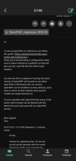

Please see attaches from my email discussion with the support.
They mention this method also:
I'm so confused as I feel in going round in circles. As I don't seek to be able to use there servers.
