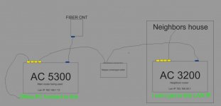

Here is what I have going on , picture attached .
That's working as expected. As I said, you need to connect to his WAN IP not his LAN IP (which will be 192.168.1.???).

Just out of curiosity, why the switch in between the two routers?
I have used a similar setup in the past, and faced a similar problem, although with a Fritzbox (A) and an ASUS (B), both functioning in router mode: Router A was connected to VDSL on its WAN port, and router B's WAN port was connected to one of A's LAN ports. (Resulting in two subnets, similar to your setup).
Assuming:
AC5300's LAN IP is: 192.168.1.12 (Subnet 1)
AC3200's LAN IP is: 192.168.50.1 (Subnet 2)
AC3200's WAN IP is: 192.168.1.63
My solution, adjusted for your subnets was:
1. Define static route on AC5300: Forward all TCP packets from 192.168.1.1/24 to destination 192.168.50.0/24 through gateway 192.168.1.63
2. Define static route on AC3200: Forward all TCP packets from 192.168.50.1/24 to destination 192.168.1.0/24 through gateway 192.168.50.1
Now, you should be able to approach each router from its own LAN side: i.e. you can enter https://192.168.50.1:8443 from subnet 1 to access AC3200's webui on subnet 2, and vice versa.
I know the solution seems somewhat redundant and counter-intuitive, but I have used it and it works. I suspect there is some hard-coded security feature within the routers' firmware that needs to be explicitly bypassed like this.
If by some chance my solution works, and you are serious about paying, please consider making a donation to the Asuswrt-Merlin project!
Best of luck!
