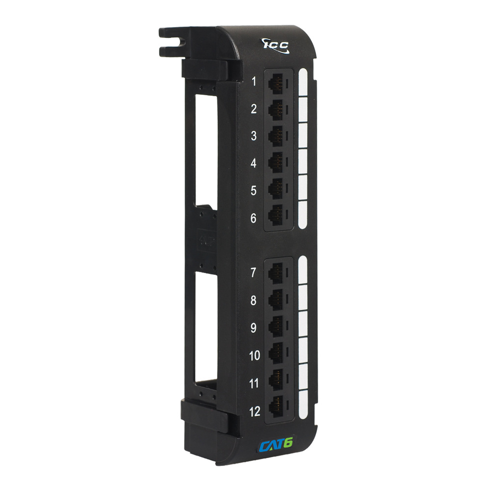

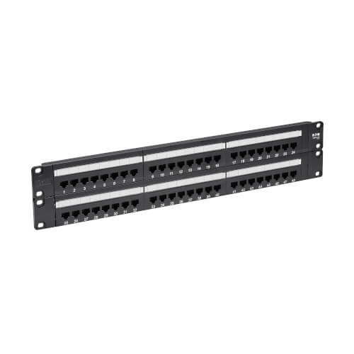

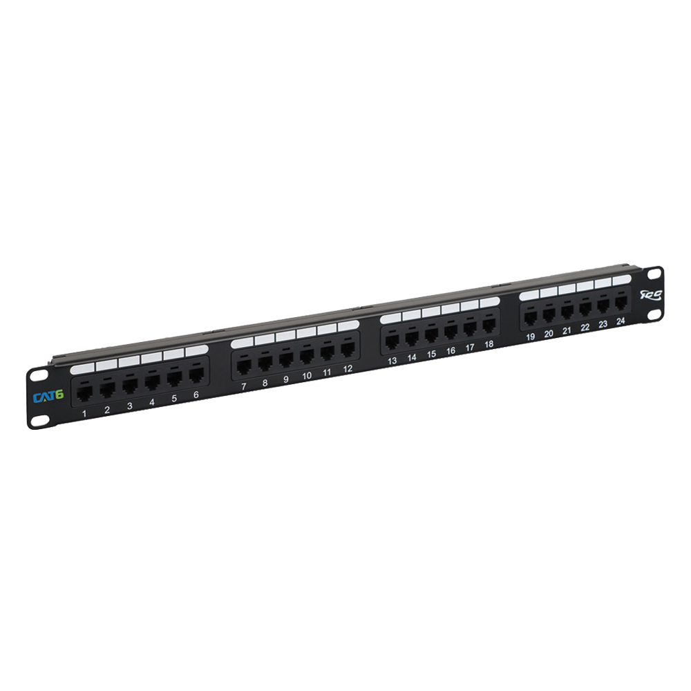

I might not have been clear in my question. I'm referring to using keystones in one of these:
versus one of these 110 style patch panels:
Keystones are easier to work with and configuration mistakes can be isolated. Imagine changing your rack location or replacing a cable.
Why not just do a 48 port panel?
The number is less of the focus.... I was just illustrating a 110 style patch panel, vs one that keystones snap into.
