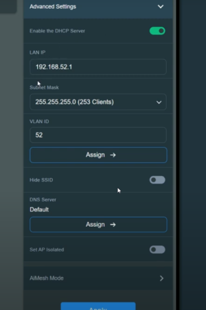

I have a question about VLANs and how to set them up. I really searched in the forum and internet. I need some step-by-step advice.
After configuring everything, I now have a super stable network—thank you! I had to replace some cables, but now the speed is superb.
Sorry for the newbie question, but I have many IoT devices and security cameras (solar panels, Google Chromecast Audio, Somfy shutters, etc.). I’d like to put them on a separate network, segmented from my Synology and other devices, but still be able to access them from the main network.
I noticed the IoT setup in Asus Merlin firmware mentions wired connections, but I can’t choose which devices to assign. I have assigned all devices manual DHCP IP addresses.
I’m using a TP-Link TL-SG108E Light Managed 1Gb switch to add more ports and connect my IoT devices. I also have Asus routers: AX88U Pro, GT-AX6000, and AX58U.
Could you recommend some up-to-date reading material or guides on how to set this up with the latest Merlin 380.06? Most resources I find are outdated or inaccurate—for example, this video (
) doesn’t represent how my router setup looks. I do not have that advanced screen :/.
Thanks in advance for your help!
