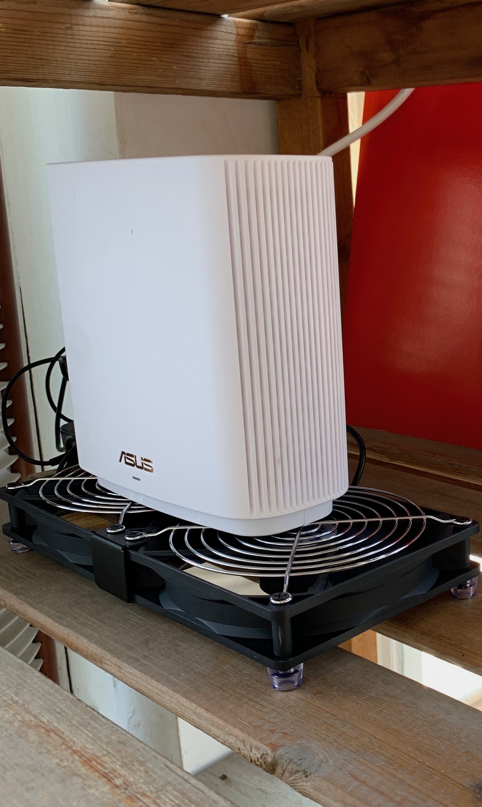

I use a fan that looks like below. The fan is powered 24/7 by a separate USB adapter.
ZgjKSJ+

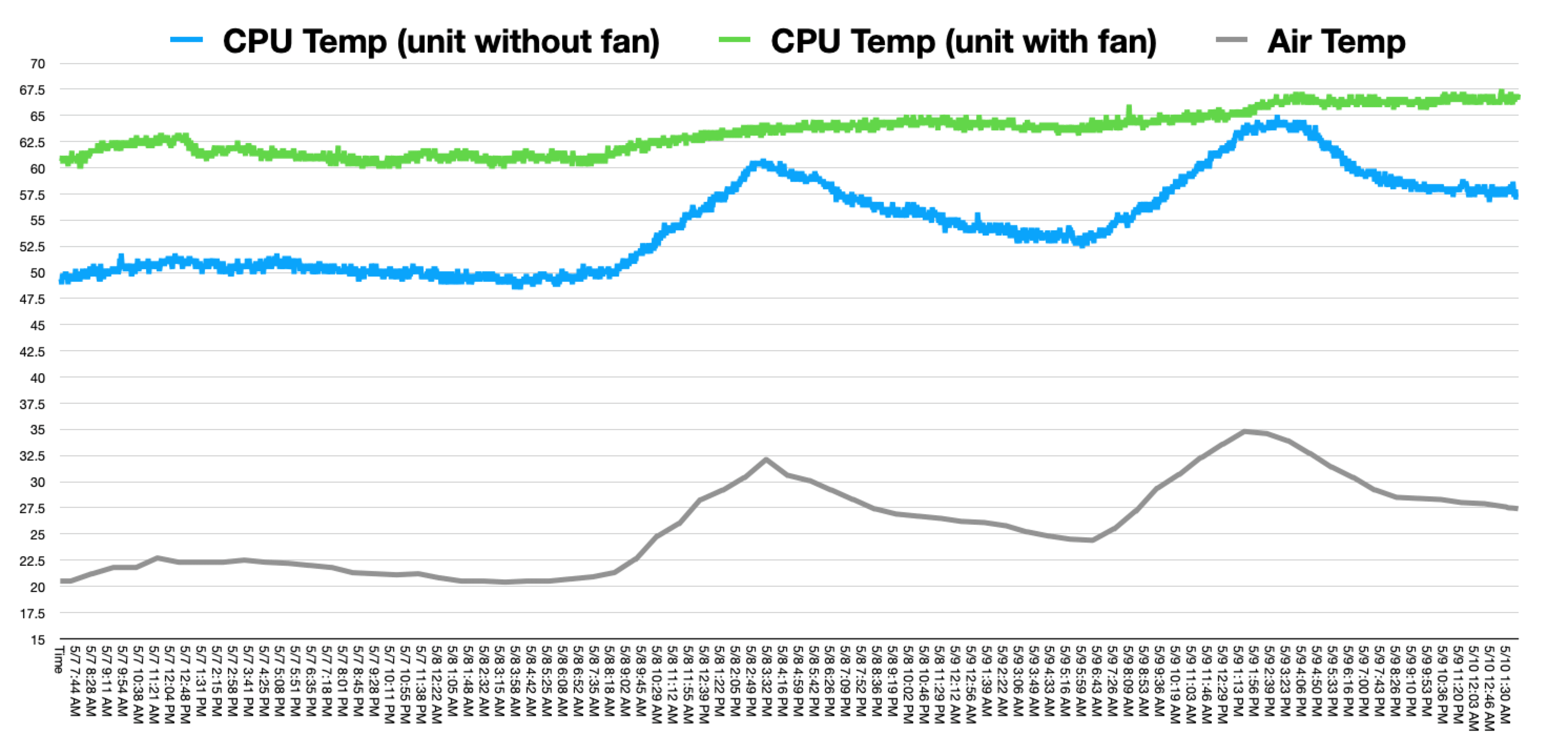

The fan provides cooling as long as the air temperature is below 40 ℃, or 104℉. This could be seen in the graph below, where I measure the CPU temperature continuously for couple days in the summer, of two units of XT8, one without the fan show in the photo above, and one with.
WkSJlw+
(The unit for vertical axis is degree celsius)
