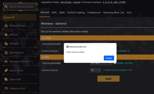

unable to configure WIFI. I can not avoid this message.
So when you click on the TAB - General, the message box is displayed ? or after trying to save a change ?
trying to save a change. and I am not able to setup wireless... I have had many routers but I am not able to configure this. WLAN is not activated.
Was 'WLAN' activated after you first Reset the router firmware to its defaults and before you configured anything?

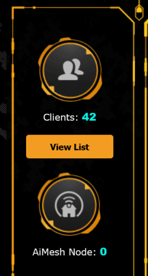

I can not believe. I am not able to see VIEW LIST. I push button but nothing. Most used button does not work. Anyone has the same problem?

Unable to view device list pushing "view list"

About the client list, were you able to try a different web browser? For example if Edge or Chrome try FireFox?
