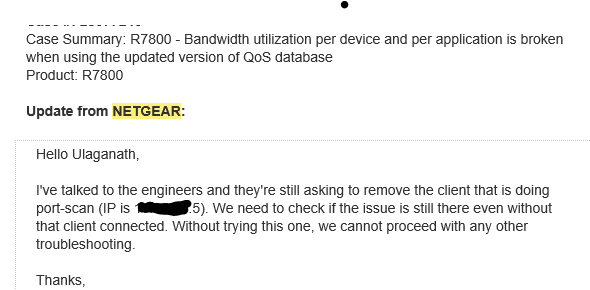

Hi Voxel,
After long time tried this firmware. As stock latest was only stable for 2-3 days. When support reverted. They said the reason for QOS failure was due to a client which is another router in the network which is doing port scanning which connects PC and NAS wired.
Does this makes sense a port scanning can cause the QOS to crash.
For now the 35F is more stable and faster even on VPN via PC client. Not router confirgured client. I get close to 90% average arround 60% of ISP Speed still way to go.

Yes they are not solving the problem yet. Also the log function of router never clearly says why and when the QOS is rebooted or crashed .
Its now visible once this crashes all the wifi connected devices losses internet abrubtly. All client need to disconnect and conenct to get internet. And the priority being reset it will be unbalance speed . though much visible
I believe the log should include process monitoring and send if any crashes abruptly

You got previously workable environment with previous version of QoS. Why not to do the same (install previous QoS).?
Voxel.
ulaganath
Very Senior Member
Yes the v2.0 wont get broken easily. But the Netgear team wants to know why it is broken in v4.0 and they wanted to update and show the same. Which i did live remote session. They themselfs downloadaed the logs and reverted after weeks saying that my router which connects the PC and NAS is the culprit which seems to do port scanning. Which could be reason for crashing the QOS.
I am going to do next time if it is broken by chance in current firmware 35F will share the log to you and if require a remote login to see yourself if it is same for you or only i am seeing it wrong way,

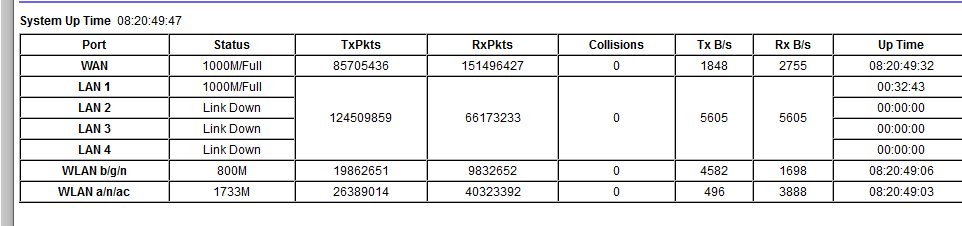

WOW wonderfull built. I can see it runs cool. Was the IRQ tool keeps stable.
I never had a running time this long on any history of firmware.

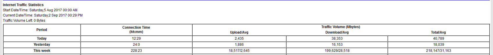

its almost 9 days still up and running fine including QOS. I get 80+% of vpn speed . Still it pc based and still i get good speed.
Not just a normal use. I would have alteast did a traffic of more than 200 gig easily with no hicups at all.
