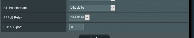

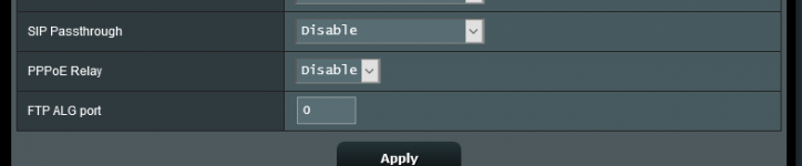

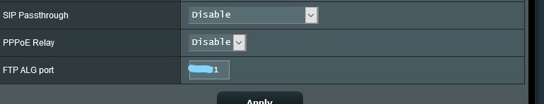

The first 2 Screenshots below show the GUI after "nvram set vts_ftpport=0" then after a reboot. the FTP ALG port reverts back to my user set FTP ALG port "xxxx1" set up originally at the Merlin GUI.
The 3rd screenshot shows the results after typing at the command prompt in ssh then rebooting:
nvram commit
The change did stick this time, though not sure if "nvram commit's" are a good policy to utilize.
