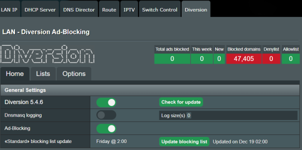

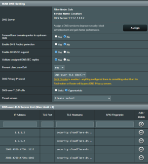

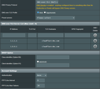

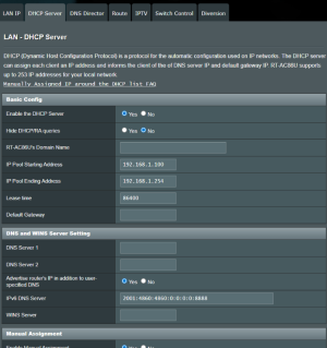

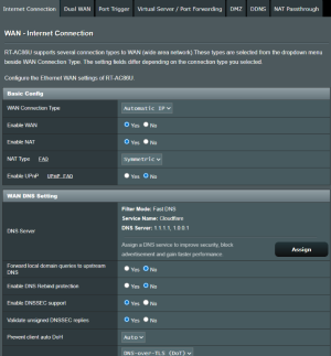

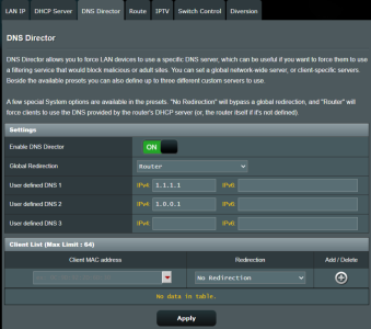

I have installed Diversion on my Asus RT-AC86U, firmware: 386.14_2. The only way I can get ad blocking to work is if I turn off secure DNS in browser (Chrome/Edge on Windows 11 or Chrome/Safari on MacOS). Is this the only way to enable Diversion on a laptop, or is there a way to have both browser-based secure DNS and Diversion ad blocking? Please see my router screenshots too in case I have configured something incorrectly. Thank you all so very much.

So are all of the settings in my router (enable DNS over TLS, DNSDirector set to router, etc.) redundant and useless? When I SSH to the router and run a test I still see domains of ad servers properly resolved. Is that an issue?
For a browser running secure DNS, yes.

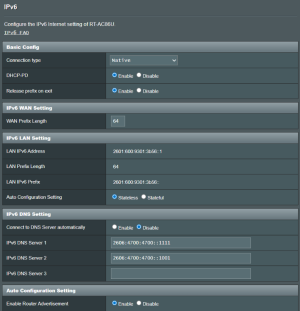

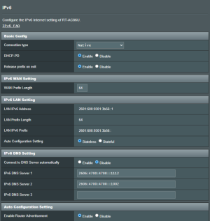

Also, why do you advertise Google DNS to your IPv6 LAN clients? That will also allow bypassing Diversion.
pagead.l.google.com does not resolve, so I guess that is a good sign. As for the Google IPv6 DNS I have no idea why it's there (I didn't put it). I will remove it. Should I also completely disable IPv6 in the router or disable only some settings? Please see my current IPv6 page.
