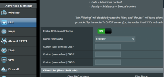

I have diversion installed on a rt-ac5300 with a small flash drive and swap file. But when I go to any website to test ad blocking, i get ads.
I know pixelserv is running because i can download the cert from 192.168.1.2/ca.crt. I installed the cert into windows (this computer). I also added it to firefox (my main browser) but I tested on chrome since I wanted to rule out me failing to properly install the cert in firefox.
I also have other devices which i can install the cert to but wanted to get it working on this (windows 10) laptop before installing the cert to mobile/tablet devices.
So the settings:
Lan:
DNSFilter:
Global filter mode: Router
Custom DNS 1-3: Blank

Okay, so I use PiHole rather than Diversion, but I think I can try and put you back on the right track!
First off LAN > DNS Filter I don't believe you even need to touch this!
LAN > DHCP Server The default (if you are using the 192.168.1.0/24 subnet) would be to set one or both of the DNS server addresses to 192.168.1.2
That should get you the basic stuff up and working (I think) - well prepared to be wrong, only answering because no one else had already!
If that works let us know, and then if you need anything more complex we can go from there!

Your original setup looked good. Crimliar's advice was bad because Pixelserv is not a DNS server. Adding it as a DNS server on the LAN page is wrong for Pixelserv (but valid for Pi-Hole).
Be sure your browsers aren't hijacking DNS with their own DoH. And be aware that Diversion includes some hardcoded whitelisted ad-domains, so you will still see some ads (not sure how you're testing it).
