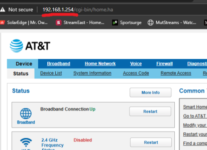

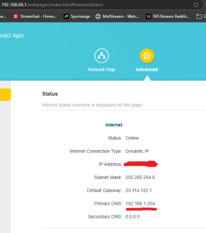

Attached a couple photos here regarding my question above. Do I have a problem here?
The DNS entry showing up if I check the TP-Link webUI corresponds to the BGW gateway. There seems to be no way to edit this, though in the TP-Link app I do have cloudflare DNS entered under Advanced->DHCP Server and clients do assign cloudflare for their DNS.
So it seems the app's settings for DNS are being pushed to clients, which is fine, but there is the matter of what I see in the TP-Link webUI page. Seems odd.

Not sure of the TP-Link UI, as I don't have a TP-Link device. But on my Asus and it's GUI, and I can only guess/assume that TP-Link has something similar, under WAN settings and then Internet Connection under the Web GUI, I can override the ISP setting and use a DNS of my choosing. Note: it's for the Router (in your case TP-Link Deco) WAN, on the LAN side / the clients it's configured as you have, under the DHCP settings, which is what the protocol used to hand out Network setting to the clients of the Router. 🤷‍♂️
In lieu of overriding that in the GUI for the WAN side, then yes the AT&T BGW320 will be the DNS for the Router, and AT&T's DNS for the BGW320 (Not configurabe), but it only impacts the Router as you have the clients using Cloudflare.
Unfortunately, there seems to be no way for me to change the value on the router side. It's not an option I can find in the app and the webUI on tp-link devices is basically read-only.
In the grand scheme, it's of minor consequence since the LAN devices are getting cloudflare per the settings in the app. I knew going to a deco mesh system ahead of time there would be some limitations and this is evidently one of them minor as it is. A slightly more annoying thing is the lack of DNS over TLS support. Not much I can do about that right now except complain to the manufacturer.
