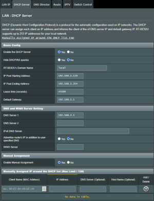

I've recently put Merlin (3006.102.6) on my RT-BE92U router with AdGuardHome running locally via amtm. Thanks to all for the great product. I have the main network at 192.168.2.0/24 and 2 other isolated networks on 192.168.52/24 and 192.168.53.0/24 for IoT and guests. Everything is working great except forcing port 53 DNS requests to go through AdGuardHome. If a client is setup to talk to 192.168.2.1, 192.168.52.1, or 192.168.53.1, respectively, which DHCP does, it works as expected. The problem is if you have a hardcoded DNS server on the client and then it isn't working. The query is redirected to the router's DNS server (so redirected from 8.8.8.8 to 192.168.2.1, for instance), but the reply comes from 192.168.2.1 and it isn't rewritten to look like it is coming from 8.8.8.8. Thus, the packet is listed as unsolicited and ignored. Below is the lots of detail if that is helpful, but if this is an easy fix feel free to ignore.

I've tried User Defined DNS 1 with that set to 192.168.2.1 and that didn't change the results.
