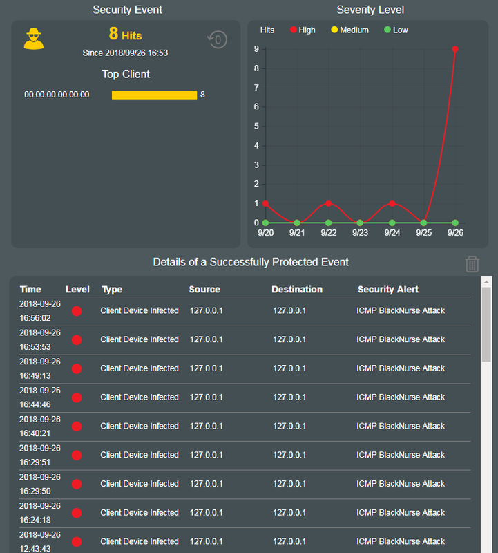

Summing up watchdog was restarting dnsmasq over and over again, ab-solution was doing the same, loading in and out of the ram. I was also getting icmp black nurse attacks from the loopback device while this was happening before, and immediately after factory default & firmware re-update; I had hardened all potential router vulnerabilities prior to plugging in wan and updated sigs immediately upon reboot. I suspect this was not an internal infection. Could this be a DNS ddos? Any Ideas?
@RMerlin, @thelonelycoder
Well 127.0.0.1 is probably not a source of an outside attack... that's the local loopback interface (used by many things, including skynet for dns filtering). This is probably a side effect of some misconfig... likely has to do with your vpn server confusing dnsmasq and/or dnscrypt. I run a similar config on my router (diversion+skynet+dnscrypt+dnssec+ovpn server) and have no similar issues. If it happens again, try getting debug logs, and see if a hard reset straightens it out.
