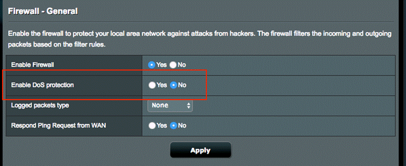

My router has the same iptables config, but DOS is off. Perhaps those are part of normal firewall settings. This is exactly like my system:
Whether the rules are in effect depends upon "-A FORWARD -i eth0 -j SECURITY".
I would be surprised if
  • DoS protection is disabled
  • and the FORWARD were in the output of "iptables -S"
Well, the router claims DOS is disabled. See screenshot above.
iptables has a bunch of SECURITY rules ans a bunch of FORWARD rules but no "-A FORWARD -i eth0 -j SECURITY".

@bertilak confirmed that the FORWARD rule (-A FORWARD -i eth0 -j SECURITY) which enables DoS Protection (via the iptables SECURITY chain) is missing.
This is as expected since DoS Protection is not enabled. What had been noticed is that the DoS rules are defined whether or not they are actually used.
