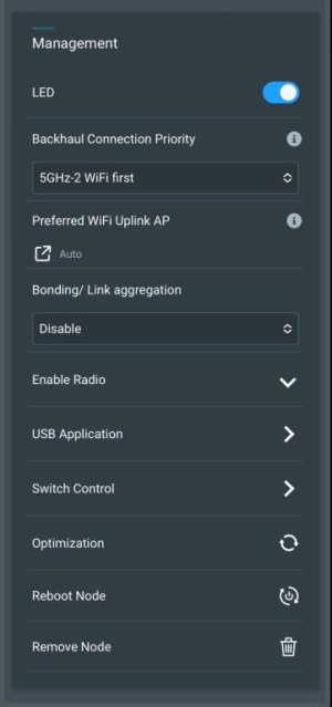

The reason why you are getting AC 866mbps on your ax92u node is because ax92u 5ghz-1 is ac only at 866mbps, while 5ghz-2 is ax at 4804mbps. If you want to have ax backhaul to ax86u, you need to go into aimesh settings and set the backhaul priority to 5ghz-2.

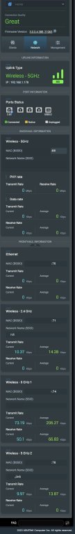

I received my xt9’s today - enabled smart connect on my ax82u and then took the second xt9 node (the one without the “start with me” sticker) and associated it to the existing network. It looks like it is using the 5ghz backhaul, but I’m new to the wireless backhaul stuff so maybe I’m missing something. Screens attached.
The limitation here should be that the ax82u can only serve at 2.4ghz,right? That would be fine with me as everything intensive can be wired.
Opinions / confirmation appreciated!
Edit - looks like the long pic is very compressed, if you need that chopped up to form an opinion let me know and I’ll do so, but you can see that 2.4, 5-1, and 5-2 are all sending / receiving.
