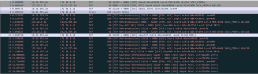

I don't suppose you found the solution to this did you? I have exactly the same issue! I've attached a quick diagram (inspired by yours!) to further explain the issue:
When connected by Wifi
PC1 is able to connect to 10.26.0.3 (pfSense firewall) without any issues. It can also PING all devices on the 172.26.0.0/16. I can;t however access any of the Web portal pages of any of the devices on the 172.26.0.0/16 subnet. I can however telnet to those servers on their relevant web portal ports!
When connected by LAN
PC1 is able to connect to everything it needs to (ping and web portals) without any issue at all.
Route table on the XT8's is as below (this does of course work as ICMP replies show!):
172.26.0.0/16 via 10.26.0.3
What I have noticed when running a WireShark on PC1 is the below:
When connected by Wifi (ignore the source IP - it's a test machine)
When connected by LAN (ignore the source IP - it's a test machine)
Seems really odd!? I have updated to the latest firmware (3.0.0.4.386_45934-gb23bdac)
