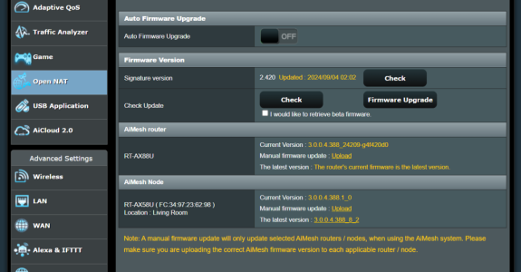

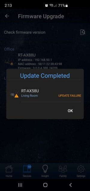

As a start I opened my ASUS app and looked under devices>AiMesh to find that the 58U node has an update available, listed as 3.0.0.4.388_8_2. To double check I referred to the WebGUI to see the same upgrade was offered there (see images). As as result , on the app, I started the f/w update process. It took about three minutes and then failed with no explanation ( see images).
To test further I consulted the ASUS drivers site at both asus.com and asus.com/ca-en to find the following update shown as available 3.0.0.4.388_24762 (dated 2024/04/12) which is different then what is shown as available on the WebGUI and app.

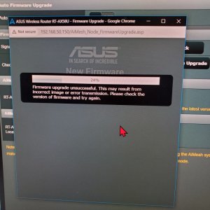

As a final step I downloaded the f/w version for the node as shown on the ASUS drivers site and tried to update using the manual upload feature on the WebGUI under administration>Firmware Upgrade>RT-AX58U Upload. That failed as well (see image) again no real explanation.

Your post is confusing. Your node is running Merlin's firmware but you're trying to update it through the Asus app. The app does not officially support Merlin's firmware. Some parts of it might work other parts won't. Assume it won't work.
You then go on to try and update the node manually via the web browser from Merlin's firmware back to stock Asus firmware. Why?
I have NEVER installed merlin on this box, or any, myself but now that you bring it up I did get this node device from a friend and thought I factory reset it as he reminded me to do so.
Since I am already part way there, can I, from the webGUI, manually upload the latest merlin update for the node to get it up to date and then update the primary to merlin?
Also what tells me it's merlin s/w vs factory?
D.
Merlin's firmware uses different version numbering than stock. See Merlin's firmware current releases here:
Factory resetting the router doesn't change the firmware version installed. It just resets the settings to their default values.
In theory yes.
