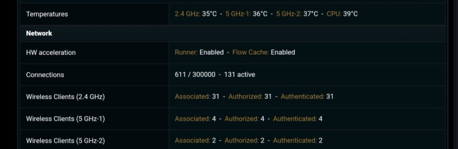

This is the status with FC control mode set to Auto mode:
ASUSWRT-Merlin GT-AX11000_PRO 3004.388.8_4 Sun Nov 17 19:18:02 UTC 2024
@GT-AX11000_Pro-40E0:/tmp/home/root# /bin/fc status
        Flow Timer Interval = 10000 millisecs
        Pkt-HW Activate Deferral rate = 1
        Pkt-HW Idle Deactivate = 0
        Pkt-SW Activate Deferral count = 0
        Flow Low Pkt Rate = 10
        Acceleration Mode: <L2 & L3>
        MCast Acceleration IPv4<Enabled> IPv6<Enabled>
        IPv6 Learning <Enabled>
        L2TP Learning <Enabled>
        GRE Learning <Enabled>
        4o6 Fragmentation <Enabled>
        TCP Ack Prioritization <Enabled>
        ToS Multi Flow <Enabled>
        Notify Processing Mode <Hybrid>
        OVS Flow Learning <Disabled>
        HW Acceleration <Enabled>
        Flow Ucast Learning Enabled  : Max<16383>, Active<166>, Cumulative [ 33447 - 33281 ]
        Flow Mcast Learning Enabled  : Max<1152>, Active<0>, Cumulative [ 0 - 0 ]

After QoS restart status shows:
        Flow Ucast Learning Enabled  : Max<16383>, Active<112>, Cumulative [ 33932 - 33820 ]

flexqos_ver 1.4.3
flexqos_iptables <>>udp>>500,4500>>3<>>udp>16384:16415>>>3<>>tcp>>119,563>>5<>>tcp>>80,443>08****>5<192.168.1.32/31>>tcp>>80,443>!04****>2<192.168.1.100/28>>tcp>>80,443>!04****>2<192.168.1.16/28>>both>>!80,443>000000>1
flexqos_iptables_names <WiFi%20Calling<Facetime<Usenet<Game%20Downloads<SmartTVs<Firestick_Streams<Gaming%20Rule
flexqos_appdb <000000>6<00006B>6<0D0007>5<0D0086>5<0D00A0>5<12003F>4<1400AC>3<13****>4<14****>4
flexqos_fccontrol 2
Any error messages if you run flexqos check from the command line?
Error below:
@GT-AX11000_Pro-40E0:/tmp/home/root# flexqos check
[: 10444.8: bad number
Error below:
Your quick fix is:
nvram set qos_ibw=87040
nvram set qos_obw=10445
nvram commit
flexqos restart
Your quick fix is:
nvram commit
flexqos restart
Just ran these commands and all is working again with FC mode set to Auto.
FC shows disabled under Tools.
Broadcom Packet Flow Cache learning via BLOG disabled.
Broadcom Packet Flow Cache flushing the flows
        Flow Ucast Learning Disabled  : Max<16383>, Active<0>, Cumulative [ 44371 - 44371 ]
        Flow Mcast Learning Disabled  : Max<1152>, Active<0>, Cumulative [ 0 - 0 ]
Thanks again for the continued support with FlexQoS.
May I ask what might have changed?
I think eventually with all the future/upcoming fw changes, I will need to switch to CAKES-QOS but in the meantime I really do appreciate the assistance!!!
The QoS page multiplies and divides by 1024 when you change the bandwidth numbers. It can result in a decimal value, which shell scripting doesn’t like.
